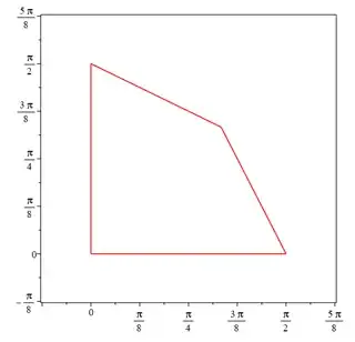

Now because of how we define the "inside" of the quadrilateral, it must be the case that $2\alpha<\pi$ and $2\beta<\pi$. Furthermore, since $\overline{AB}$ and $\overline{BC}$ must intersect, $2\alpha+\beta<\pi$. Likewise, $\alpha+2\beta<\pi$.
This valid region for $\alpha$ and $\beta$ is shown below, excluding the boundary.
Note that because of this range of allowable values of $\alpha$ and $\beta$, the sines and cosines of these angles are positive.

Now
$$(4\sin\alpha\cos\alpha\sin\beta\cos\beta-4\sin^2\alpha\sin^2\beta+2-2(\cos^2\alpha+\cos\alpha\cos\beta+\cos^2\beta))<0$$
for all $\alpha$ and $\beta$ in the legal range†. (It is exactly zero at $\alpha=0,\beta=\frac{\pi}{2}$ and vice versa.) This means that
$$\cos\alpha-\cos\beta=0$$ $$\Rightarrow \alpha=\beta$$
Now clearly the base angles $2\alpha$ and $2\beta$ are equal. By SAS congruence, we get that $\triangle ABD$ and $\triangle DCA$ are congruent. Therefore the base side lengths $b$ and $d$ are equal.
Verified graphically. A full proof would likely include function maximization to show that the expression does not exceed $0$.
