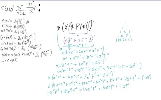

This came up when trying to evaluate $\sum n^3/2^n$. In order to do this I had to repeatedly differentiate and multiply by $x$ to make the function match the summation. What are these numbers, and why do they show up here? I would appreciate some more insight as to how exactly these coefficients of the expansion come about through this iterated process

    I think that the number triangle is OEIS sequence A008278 "Reflected triangle of Stirling numbers of 2nd kind, S(n,n-k+1), n >= 1, 1 <= k <= n." – Somos Jul 24 '22 at 02:30

Consider, for the time being $$S=\sum_{n=1}^p n^3\, x^n$$ and write $$n^3=n(n-1)(n-2)+3n(n-1)+n$$ $$S=\sum_{n=1}^p n(n-1)(n-2)\, x^n+3\sum_{n=1}^p n(n-1)\, x^n+\sum_{n=1}^p n\, x^n$$ $$S=x^3\sum_{n=1}^p n(n-1)(n-2)\, x^{n-3}+3 x^2\sum_{n=1}^p n(n-1)\, x^{n-2}+x\sum_{n=1}^p n\, x^{n-1}$$ $$S=x^3\Bigg[\sum_{n=1}^p x^n \Bigg]'''+3x^2\Bigg[\sum_{n=1}^p x^n \Bigg]''+x\Bigg[\sum_{n=1}^p x^n \Bigg]'$$ and $$\Bigg[\sum_{n=1}^p x^n \Bigg]=\frac{x \left(x^p-1\right)}{x-1}=1+\frac{ \left(x^p-1\right)}{x-1}$$ When finished, let $x=\frac 12$
    Good old Stirling numbers. They have been rediscovered so many times, including by me many years ago. – marty cohen Jul 24 '22 at 04:40

Partial Answer:
A check on the OEIS, entry $A000278$ suggests these coefficients are the (reflected triangle of the) Stirling numbers of second kind.
The Stirling numbers of the second kind (Wikipedia) give the number of ways to partition an $n$-member set into $k$ nonempty and unlabeled subsets. One may algebraically define
$$\newcommand{\S}[2]{{#1 \brace #2}} \S n k := \frac{1}{k!} \sum_{i=0}^k (-1)^i \binom k i (k-i)^n $$
Wikipedia offers a table of some values:
Notice how if you left-align your triangle, strip away the below table's first column, and then reverse the order of entries in your triangle (or Wikipedia's), you get a match.
I have no particular insight as to why these numbers pop up in your summation, however.
