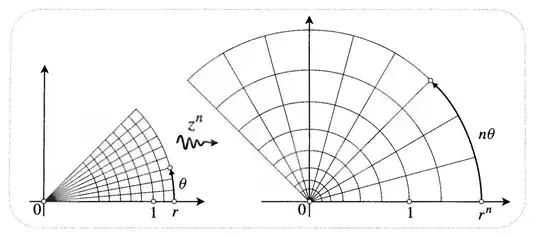

In his book, Visual Complex Analysis, Needham gives a very beautiful visualization of the geometry of this:
Note that this is an excerpt from Needham's book, Visual Complex Analysis, used under fair use, not something I own copyright to. SE policy seems to allow this. (Note that this is an excerpt from his book used under fair use.)
(Actually, Needham gives lots of awesome visualizations like this, and I'd encourage people to look at the book. It's an amazing work of mathematical exposition.)
Notice how argument scales as we raise the power, and magnitude is exponentiated!

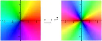

Another way to look at this is using colors! We map each complex number to a color, with hue being argument and brightness being magnitude. In this example, we square:
Notice how the argument (hue) cycles twice as fast in the image as we go around, because it changes twice as fast (being multiplied by 2)!
