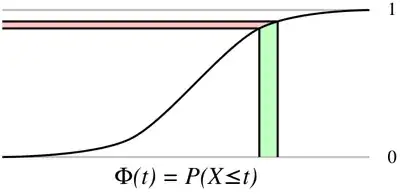

Suppose a random variable $X$ has the Cumulative Distribution Function $\Phi(t)=P(X\le t)$:
$\hspace{3.2cm}$enter image description here
The probability of $X$ being within the base of the green region, is the height of the red region. Thus, $\Phi(X)$ is uniformly distributed along the vertical axis, $[0,1]$. Therefore, $\Phi^{-1}(U)$ has the same distribution as $X$ where $U$ is uniformly distributed in $[0,1]$.
As long as the region is radial, the CDF of being within $t$ of the origin is $$ \Phi(t)=\frac{t^3}{r^3} $$ Thus, we get the proper distribution of the distance from the origin with $$ r\,u^{1/3}\tag{1} $$ where $u$ is uniform in $[0,1]$.

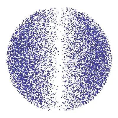

10000 Points: Generated using $(2)$ and $(3)$ (top is approaching; bottom is receding)
$\hspace{3.5cm}$enter image description here
10000 Points: Generated using $(2)$ and $(4)$ (top is approaching; bottom is receding)
