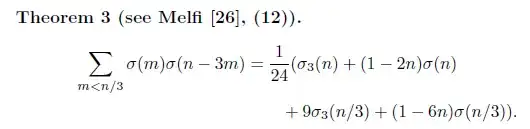

I find this:(From Elementary Evaluation of Certain Convolution Sums Involving Divisor Functions by Huard et al. On page 20)
so we are done.
