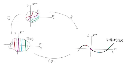

As a result of this, we have that \begin{align} (f\circ\Phi^{-1})(\xi,\eta)&=\bigg(\xi,(f_2\circ\Phi^{-1})(\xi,0)\bigg).\tag{$\ddot{\smile}$} \end{align} Notice in particular the RHS doesn't depend on $\eta$. Now, we can truly say $\Phi$ has straightened out the domain of $f$ in the following sense:
domain straightening
So, in the picture, the image of $f$ is given by the graph of the function $\xi\mapsto (f_2\circ\Phi^{-1})(\xi,0)$. Each point on the graph has a certain preimage under $f$, which in the set $E$ is given by some squiggly curve, but if you look at the preimage under $f\circ\Phi^{-1}$, it is straight lines. So, $f\circ\Phi^{-1}$ is constant on each of these straight vertical lines.

Hopefully now it's clear what $U,V$ are: they're just small open sets which are the domain of a certain diffeomorphism (change of coordinates). In the above presentation, I have (by slight abuse of notation) referred to them as $E$ and $\Phi(E)$. Rudin's $H$ corresponds to my $\Phi^{-1}$. The point is that $\Phi$ straightens out the domain as above. Now, in my formulation, we can write the equality $(\ddot{\smile})$ as \begin{align} (f\circ\Phi^{-1})(\xi,\eta)&=(\xi,0)+(0,(f_2\circ\Phi^{-1})(\xi,0))\tag{$**$}; \end{align} this sum is the analogue of what is in Rudin. It's just that Rudin didn't perform the reductions by affine transformations initially which is why he has to carry around the null space, range and projections everywhere in the formulas.
But hopefully the formula as stated in $(**)$ is clear geometrically: a point $(\xi,(f_2\circ\Phi^{-1})(\xi,0))$ on the graph ($F(H(x))$ in Rudin's notation) is specified by its projection $(\xi,0)$ to the Horizontal axis ($Ax$ in Rudin's notation), and its projection to the vertical axis, $(0,(f_2\circ\Phi^{-1})(\xi,0))$ which is the amount by which we have to move 'above' the base point $(\xi,0)$ (this extra sum is denoted $\phi(Ax)$ in Rudin's notation).
