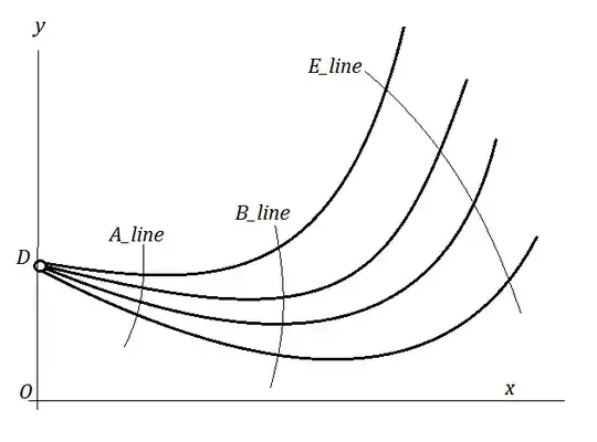

I have the coordinates of one extreme point $D=(0,y_D)$, two lines $y = m_ix + y_D$ for $i\in \{ A,B \}$ intersecting the catenary at two point $A$ and $B$, and also in $D$. I know the length $L_{DA}$ of the catenary from $D$ to $A$, $L_{AB}$ from $A$ to $B$ and the overall length $L_{DE}$ from $D$ to $E$. I want to find the coordinates of the second extreme point $E$, as per the linked picture ($L = L_{AB}$).
My understanding is that given these conditions (one point, two intersections and a known distance between the intersections) the solution must be unique. My approach would be to find the equation of the catenary and then locate $E$, $L_{DE}$ away from the starting point $D$ along the curve.

  • Thanks, this works. It is more elegant than the one i proposed, as it does not rely on the estimation of $x_A$ and $x_B$ with Newton's method. It also seems to converge to the correct solution more easily, given different initial conditions. I would also note that equations $(5)$ and $(7)$ are not strictly necessary to solve the optimization problem, i.e. the length $L_{DE}$ is superfluous. On the other hand, $(7)$ easily identifies where the endpoint is, if $L_{DE}$ is finite. I would upvote the answer, but I don't have enough reputation... – Michele Bolognini Jun 01 '22 at 06:51

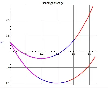

EDIT1
Mathematica platform numerically computed Catenaries with varying arc lengths, two initial slopes at D = (- 0.85,-1.12).

  • 40,495
