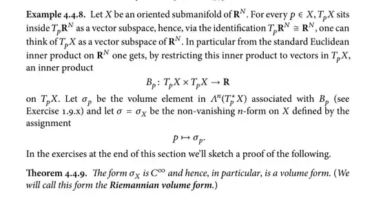

On my homework, I have a question: "Let $S^n$ be the $n$-sphere and $\iota: S^n \to \mathbb{R}^{n+1}$ the inclusion map. Show that if $\omega \in \Omega^{n}(\mathbb{R}^{n+1})$ is the $n$-form $\omega = \sum_{i=1}^{n+1} (-1)^{i-1}x_idx_1 \wedge \cdots \wedge \widehat{dx_i} \wedge \cdots \wedge dx_{n+1}$, the $n$-form $\iota^*\omega \in \Omega^n(S^n)$ is the Riemannian volume form." I have attached an image showing what my book gives on the Riemannian volume form (Exercise 1.9.x just says that for $\omega \in \bigwedge^n(V^*)_+$ that $i*(\iota_v\omega) \in \bigwedge^{n-1}(W^*)_+$ where $i: W \to V$ is the inclusion map, $V$ is an $n$-dimensional and $W$ is an $n-1$ dimensional subspace of $V$): enter image description here
I am super confused on how to go about solving this problem. It doesn't feel like I have much to work with per say, and I am totally stuck. I've tried looking at other posts on this subject but they don't seem to define it in the same way as my book does. Any hints would be greatly appreciated!

  • So what is $\sigma_p$? – Arctic Char May 29 '22 at 22:43
  • If I understand correctly, it is $dx_1 \wedge \cdots \wedge dx_n$, but I could be wrong. It is only stated as "the volume element in $\bigwedge^n(T^*_pX)$ associated with $B_p$" and I have no idea how it is associated with $B_p$ since it is never mentioned in the exercise. Hence my troubles with the problem – junglekarmapizza May 29 '22 at 22:54
