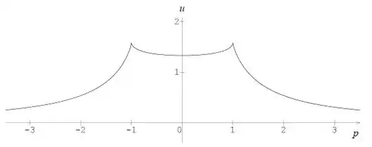

$$u(p) = \frac{1}{p}\left((1 + p)^\frac{2}3 - (1 - p)^\frac{2}3 \right)$$
I am not sure to well understand what you are looking for. Sorry if my answer is not what you want.
If the question is only to plot $u(p)$ and nothing more, this seems too obvious : In your drawing software replace plot(p,u) by plot(u,p). Which means that for each point (p given and u computed) draw the pixel (u,p) i.e. abscisse=u and ordinate=p.
If you cannot do that, first plot $u(p)$ : next figure.
Then draw the symetric curve wrt the first bisectrice : next figure
I don't see any need to analytically solve the equation for $u$.
Note : The figures have been corrected ( There was a bug in the code for drawing them).
