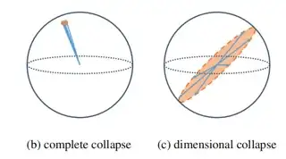

I am reading the paper "Understanding dimensional collapse in contrastive self-supervised learning." The authors identified a dimensional collapse phenomenon:
i.e. some dimension of embedding collapses to zero. They show this by collecting the embedding vectors on the validation set. Each embedding vector has a size of $d=128$, then compute the covariance matrix $C\in\mathbb{R}^{d\times d}$. Then the singular value decomposition is applied on the covariance matrix. They state that a number of singular values collapse to zero, thus representing collapsed dimensions.
Thus my questions are:
  1. What does singular value decomposition of covariance matrix represent?
  2. Why a number of singular value of covariance matrix collapse to zero can represent these dimension of embedding collapse?

    Sure SVD is normally applied to the data matrix. Regarding your question: Isn't a PCA (diagonalization of the covariance matrix) not just a special case of an SVD of it ? It is probably time to post a link to the paper you are reading. The images tell me nothing. – Kurt G. Apr 22 '22 at 08:39
This is essentially the definition of PCA, where you calculate covariance matrix (C) of data D, and perform SVD on C to find orthogonal directions that captures of the majority of total variance. I think your question is why using covariance matrix? This is because covariance matrix captures the total variance distribution in the data D, the diagonal entries are variance of each of the variables and off-diagonal entries capture linear correlation between each pair of variables in D.
  1. Why a number of singular value of covariance matrix collapse to zero can represent these dimension of embedding collapse?
In PCA, the matrix in the middle $\Sigma$ represents the eigenvalues of each principal component direction found. This matrix is diagonal and can contain positive or 0 eigenvalues. The number of non-zero eigenvalues are called rank. The rank represents the minimal number of dimensions to compress D without losing variance.
