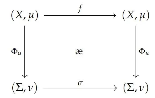

It might be instructive to think of this as coding. Let me set up some notation first: say $(X,\mu)$ is a probability space, let $f:(X,\mu)\to (X,\mu)$ be a measurable measure-preserving map. Consider the shift space $\Sigma=F(\mathbb{Z}_{\geq0};\mathbb{R})$ on which the shift operator acts:
$$\sigma: \Sigma\to \Sigma, \omega_\bullet\mapsto \omega_{\bullet+1}.$$
(Explicitly $\sigma(\omega_0,\omega_1,...,\omega_n,...)=(\omega_1,\omega_2,...,\omega_{n+1},...)$.)
We think of $\Sigma$ to be endowed with the product topology and associated Borel $\sigma$-algebra.
For any measurable function $u:X\to \mathbb{R}$ we have an associated coding map $\Phi_u$. This is a measurable map $\Phi_u:X\to\Sigma$ defined by
$$x\mapsto [n\mapsto u\circ f^n(x)].$$
Denoting by $\nu=\overrightarrow{\Phi_u}(\mu)$ the pushforward measure we have a commutative diagram (in the a.e. category of probability spaces):
Note that the setup here matches exactly with your setup ($(X,\mu)$ is $(\Omega,Q)$, $f$ is $\varphi$, $u$ is $X_0$, $\Sigma$ is $\mathbb{R}^\infty$, $\nu$ is $P$, $\sigma$ is $\theta$).
