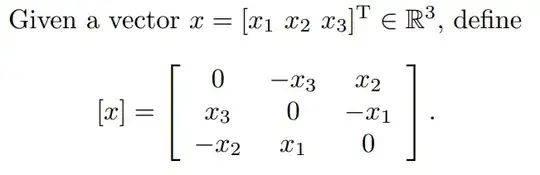

We can take advantage of the Rodrigues' rotation formula to generate rotation matrices.
Image of the Rodrigues' rotation formula
Image of the bracket notation
With this, you only need to generate a random 3x1 unit vector (as the rotation axis) and specify a rotation angle. This formula will transform them into a valid rotation matrix.

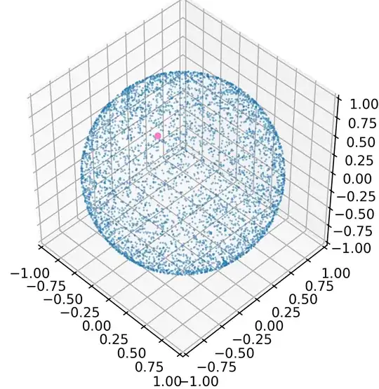

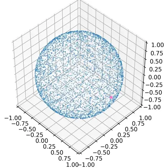

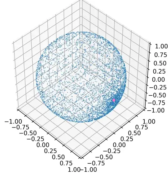

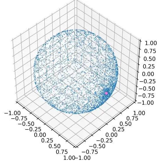

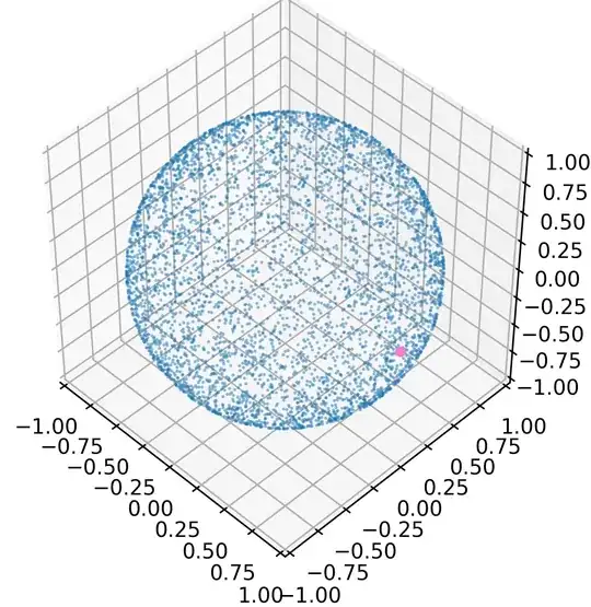

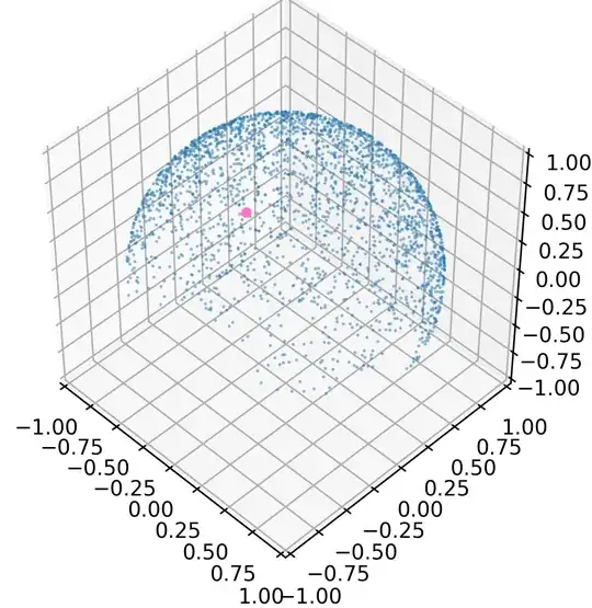

Empirical visualizations of various answers.
Initial
point
qr_full
randn_orthobasis
randn_axis
$\psi$ corrected
nbubis
$\psi$ corrected
randn_axis
$\psi \sim \mathcal{U}(0, 2\pi)$
nbubis
qr_half
$(1, 0, 0)$
$(\frac{1}{9}, -\frac{4}{9}, \frac{8}{9})$
The pink point denotes "initial" point. The blue points are the result of rotating the initial point using 5000 randomly generated 3x3 rotation matrices.

def qr_full(num_samples=1): z = np.random.randn(num_samples, 3, 3) q, r = np.linalg.qr(z) sign = 2 * (np.diagonal(r, axis1=-2, axis2=-1) >= 0) - 1 rot = q rot = sign[..., None, :] rot[:, 0, :] = np.linalg.det(rot)[..., None] return rot
https://math.stackexchange.com/questions/442418/random-generation-of-rotation-matrices/1288873#1288873
https://math.stackexchange.com/questions/44689/how-to-find-a-random-axis-or-unit-vector-in-3d/44701#44701
def randn_orthobasis(num_samples=1): z = np.random.randn(num_samples, 3, 3) z = z / np.linalg.norm(z, axis=-1, keepdims=True) z[:, 0] = np.cross(z[:, 1], z[:, 2], axis=-1) z[:, 0] = z[:, 0] / np.linalg.norm(z[:, 0], axis=-1, keepdims=True) z[:, 1] = np.cross(z[:, 2], z[:, 0], axis=-1) z[:, 1] = z[:, 1] / np.linalg.norm(z[:, 1], axis=-1, keepdims=True) return z
https://math.stackexchange.com/questions/442418/random-generation-of-rotation-matrices/4394036#4394036
def randn_axis(num_samples=1, corrected=True): u = np.random.uniform(0, 1, size=num_samples) z = np.random.randn(num_samples, 1, 3) z = z / np.linalg.norm(z, axis=-1, keepdims=True)
if corrected:
    t = np.linspace(0, np.pi, 1024)
    cdf_psi = (t - np.sin(t)) / np.pi
    psi = np.interp(u, cdf_psi, t, left=0, right=np.pi)
else:
    psi = 2 * np.pi * u
return rot3x3_from_axis_angle(z, psi)
https://math.stackexchange.com/questions/442418/random-generation-of-rotation-matrices/442423#442423
https://math.stackexchange.com/questions/44689/how-to-find-a-random-axis-or-unit-vector-in-3d/44691#44691
def nbubis(num_samples=1, corrected=True): u1 = np.random.uniform(0, 1, size=num_samples) u2 = np.random.uniform(0, 1, size=num_samples) u3 = np.random.uniform(0, 1, size=num_samples)
theta = np.arccos(2 * u1 - 1)
phi = 2 * np.pi * u2
axis_vector = [
    np.sin(theta) * np.cos(phi),
    np.sin(theta) * np.sin(phi),
    np.cos(theta),
axis_vector = np.stack(axis_vector, axis=1).reshape(-1, 1, 3)
if corrected:
    psi = np.interp(u3, cdf_psi, t, left=0, right=np.pi)
else:
    psi = 2 * np.pi * u3
return rot3x3_from_axis_angle(axis_vector, psi)
https://math.stackexchange.com/questions/442418/random-generation-of-rotation-matrices/1602779#1602779
def qr_half(num_samples=1): z = np.random.randn(num_samples, 3, 3) q, r = np.linalg.qr(z) return q
https://en.wikipedia.org/wiki/Rodrigues%27_rotation_formula#Matrix_notation
def rot3x3_from_axis_angle(axis_vector, angle): angle = np.atleast_1d(angle)[..., None, None] K = np.cross(np.eye(3), axis_vector) return np.eye(3) + np.sin(angle) * K + (1 - np.cos(angle)) * (K @ K)
def plot_scatter(pointses, filename, kwargses): fig = plt.figure() ax = fig.add_subplot(projection="3d", computed_zorder=False) for points, kwargs in zip(pointses, kwargses): ax.scatter(np.asarray(points).T, marker=".", *kwargs) ax.view_init(elev=45, azim=-45, roll=0) ax.set(xlim=(-1, 1), ylim=(-1, 1), zlim=(-1, 1)) ax.set_aspect("equal", adjustable="box") fig.savefig(filename, dpi=300, bbox_inches="tight", pad_inches=0) # plt.show() # exit() plt.close(fig)
METHODS = { "randn_orthobasis": randn_orthobasis, "randn_axis": randn_axis, "randn_axis_incorrect": lambda kwargs: randn_axis(corrected=False, kwargs), "nbubis": nbubis, "nbubis_incorrect": lambda kwargs: nbubis(corrected=False, kwargs), "qr_half": qr_half, "qr_full": qr_full, }
x is the starting point; y contains various sample rotated points.
x = np.array([1.0, 0.0, 0.0])
x = np.array([1 / 9, -4 / 9, 8 / 9]) x /= np.linalg.norm(x) # Normalize to unit vector, just in case.
for name, func in METHODS.items(): rot = func(num_samples=5000 // (2 if "half" in name else 1)) y = rot @ x plot_scatter( [y, [x]], f"rot3x3{name}.png", [{"s": 1, "alpha": 0.5}, {"s": 64, "color": "#ff77cc"}], )
Notes:
  • qr_half does not cover the full space of rotations.
  • qr_full corrects qr_half by randomly flipping the signs of the columns of the resulting rotation matrix, while imposing the required constraint $\det T = 1$ so that $T \in \mathcal{SO}(3)$.
  • randn_orthobasis generates two random vectors, and then generates an orthonormal basis from this by taking a bunch of cross products. A more generic orthonormalization method may be used instead for higher dimension matrices (e.g., 4x4, 5x5, ...).
  • randn_axis and nbubis both generate a random 3x3 rotation matrix using a spherically-uniform random axis vector, then a random angle of rotation about this vector. However, choosing $\psi \sim \mathcal{U}(0, 2\pi)$ has a counterintuitive consequence: the initial points are more likely to remain near their starting positions. To repair this, we must make it less likely to choose small angles by choosing $\psi \sim \frac{d}{du} \left( \frac{1}{\pi} (u - \sin u) \right)$, where $u \sim \mathcal{U}(0, \pi)$. In practice, we can use "inverse transform sampling" to sample from the corresponding CDF by simply interpolating over its inverse.
Mateen Ulhaq
  • 1,211
