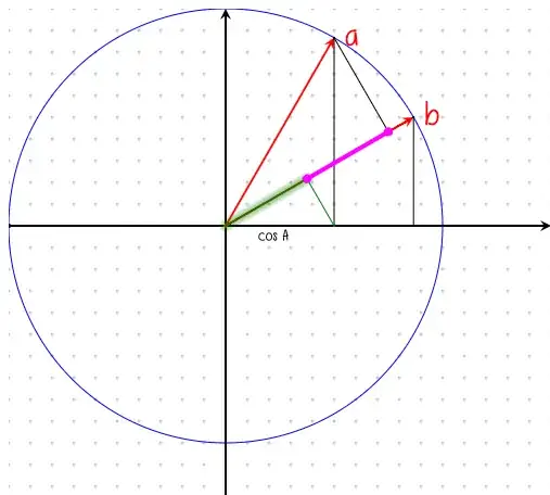

In the above figure, $a,b$ are unit vectors. The angle between them is $A-B$.
It is easy to see the green highlighted part is: $$\cos A \cos B$$
This means the magenta part must be $$\sin A \sin B$$
Is there a way to prove this elegantly?
My work:
I tried various similar triangle ratios, then a lot of trig simplification and arrived at the answer. I don't even want to attempt it again. It's a lot of mess.
I was hoping to get a more geometric intuition for the magenta segment. Any help?
Why I'm looking for geometric intuition:
The product $\cos A \cos B$ changes when the plane rotates
The product $\sin A \sin B$ changes when the plane rotates
But their sum $\cos A \cos B + \sin A \sin B $ doesn't change!
I fully understand the algebra - rotation matrix is orthonormal and preserves the dot product: $$(Ra)' Rb = a'R'Rb = a'Ib = a\cdot b$$ Seeking geometric intuition if possible...

Divide the vertical line from $a$ into two parts at the magenta line, say $x$ and $y$, such that $x+y=\sin \alpha$.
The angles formed at the endpoints of the vertical from $a$ are corresponding angles, and are equal to $\beta$.
The vertical from $a$ also splits the magenta line into $x\sin\beta$ and $y\sin\beta$, and $(x+y)\sin\beta = \sin\alpha\sin\beta$.
JMP
  • 21,771
  • Ah! so the magenta line is just a projection of y coordinate of A over B ? If so, then the projection of A over B can be obtained by adding up individual projections of x,y coordinates separately... interesting... – across Apr 02 '22 at 01:37

You should add something to your picture.
Let $\angle AOC=x$, $\angle BOC=y$, $OA=1$. Then $OB=\cos(x-y)$. $\angle FAD=\angle BOC=y$. Also $OB=OE+EB=OE+DF=OD\cos y+AD\sin y=\cos x\cos y+\sin x \sin y$. Then $\cos(x-y)=\cos x\cos y+\sin x \sin y$
  • Slick! Earlier I missed seeing $DF = AD\sin(y)$ and so went in a completely different dir. Thank you so much XD – across Apr 01 '22 at 16:12
