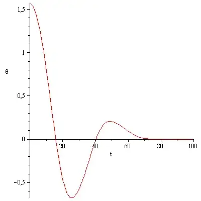

Is the solution to $\ddot{\theta}+0.021\,\text{sgn}(\dot{\theta})\sqrt{|\dot{\theta}|}+0.02\sin(\theta)=0,\,\,\theta(0)=\frac{\pi}{2},\,\dot{\theta}(0) = 0 \quad\text{(Eq. 1)}$ of finite duration?
I would like to know if the solution is of finite duration, meaning this that the solution reaches zero in finite time and stays there forever after (instead of being "vanishing at infinity"). Looking for a mathematical prove of that (theoretical or numerical, but such as confirms without any doubt if is truly a solution of finite duration).
Numerical solution to Eq . 1
To be explicit about what I am asking for, here is an example: lets think in the equation $\dot{y}=-\sqrt{y},\,y(0)=1$ which has as solution $y(t)=\frac{1}{4}\left(t-2\right)^2$, here the solution is not of finite duration, since after reaching zero at $t=2$, it will start to rising again. But the equation $\dot{x} = -\text{sgn}(x)\sqrt{|x|},\,x(0)=1$ will have as solution $x(t) = \frac{1}{4}\left(1-\frac{t}{2}+\left|1-\frac{t}{2}\right|\right)^2$ which indeed is of finite duration reaching zero at $t=2$ and staying there forever (see plot here, and demo here). I want to know if the solution $\theta(t)$ behaves at the end like the solution $x(t)$, reaching zero at some ending time and staying there forever.

  1. Solving Eq. 1 for $\ddot{\theta}(t) = 0$ leads to a $\tan^{-1}$ which never achieves exactly zero. Here is the attempt done by other person in the question of the physics forum. Interestingly are found a time $T \approx 90$ which is similar to the plot ending.
  2. Solving Eq. 1 for $\dot{\theta}(t) = 0$ will lead to the classic equation of the nonlinear pendulum without friction, which solutions are Jacobi Elliptic functions, so since are periodic, there are going to be infinite times where it lands on zero (I have a related question here).
  3. Solving Eq. 1 for $\theta(t) = 0$ leads to $\dot{\theta}(t) = \frac{a^2}{4}(T-t)^2H(T-t)$ as is explained here, which looks promising since it has only one ending time $T$, but with the actual initial conditions it shows to be centered at $T=0$ (at least under my approach), so it don´t work either (since from the plot the only point with $\ddot{\theta}=\dot{\theta}=0$ is at the end, I was hopeful about its validity). Maybe here I am making some mistake, so If someone could try it too and can fix it it will solve the question, since founding $T$ such as $\theta(T)=\dot{\theta}(T)=0$ will answer the problem (if I am not mistaken).
