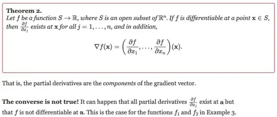

So how do I prove that if a function is totally differentiable, then the linear transformation must be its Jacobian?
Here is my attempt, but I would love feedback:
  • To prove this, I was thinking of applying similar logic to this answer, which is for the single-variable case but reveals a great strategy we can use
  • To simplify the proof, let's assume the function f has single-valued outputs because otherwise we can just apply logic component-wise
  • Likewise, we really only need to bother proving this for two variables
  • Now, the first thing I would do is reduce the problem of determining the unique linear transformation to one coordinate at a time
  • By only changing one variable at a time, we can write equations that would let us leverage tools from one-dimensional calculus. We would get equations which are the definition of the partial derivatives
  • This would naturally force that the linear map must be made up of the partial derivatives of f, which in turn forces the map to be equal to the Jacobian
  • No other transformation can satisfy these one-dimensional equations, so it is unique (but we also already knew that the mapping had to be unique)
  • Then I suppose my work is done! If there does exist a linear map that satisfies the definition of total differentiability, then it must be the Jacobian, due to the one-dimensional cases that must also be satisfied
However, this almost feels like an accident rather than a proof. Am I missing something?
What spooks me out is we are already out of information (all coordinates of the total derivative have been specified), but we have only tested one direction at a time! If we were to make an arbitrary change in an arbitrary direction, how would we then bound the errors? Simply put, we cannot, by just knowing the Jacobian alone. I suppose that is a task beyond the partial derivatives, and that all we have established here is that if the function indeed ends up being differentiable (through other analysis), then it must have a total derivative equal to the Jacobian.

With this connection made, we can then do things like this to prove whether a multivariable function indeed is differentiable. Notice how this article actually flipped around the order of things: starting with the partial derivative based definition of the total differential, and then defining differentiability around that. In either case, knowing how partial derivatives relate to the total derivative through the definition of differentiability gives us a wonderful toolkit for determining if multivariable functions are differentiable.
Edit: I found a full exposition here, done from scratch. Thanks all!
http://www.math.toronto.edu/courses/mat237y1/20199/notes/Chapter2/S2.1.html

Theorem on Connection Between Partials and Derivative
