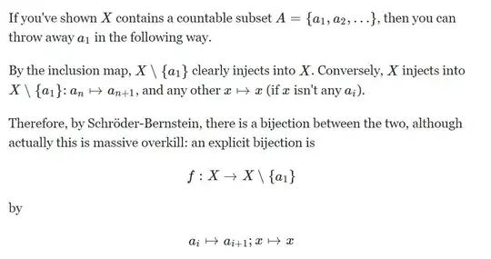

(2)$\Rightarrow$(1) To prove this direction in (ZF) we need the condition "X is a Dedekind-infinite set" instead of just an infinite set. However, we can prove it in (ZF + ACw) applying the axiom of countable choice:
In wikipedia you can find the proof that every infinite set is Dedekind-infinite in (ZF + ACw).
