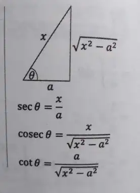

$$=-\frac{1}{a}\ln\left|\frac{x}{\sqrt{x^2-a^2}}+\frac{a}{\sqrt{x^2-a^2}}\right|+C\\ =-\frac{1}{a}\ln\left|\frac{x+a}{\sqrt{x-a}\sqrt{x+a}}\right|+C\\ =-\frac{1}{a}\ln\left|\frac{\sqrt{x+a}}{\sqrt{x-a}}\right|+C\\ =-\frac{1}{a}{\ln\left|\frac{x+a}{x-a}\right|}^{\frac{1}{2}}+C\\ =-\frac{1}{2}.\frac{1}{a}\ln\left|\frac{x+a}{x-a}\right|+C\\ =\frac{1}{2a}{\ln(\left|\frac{x+a}{x-a}\right|)}^{-1}+C\\ =\frac{1}{2a}\ln\left|\frac{x-a}{x+a}\right|+C.$$

  4. Notice that the author writes $$\operatorname{cosec}\theta=\frac x{\sqrt{x^2-a^2}}\\ \cot\theta=\frac a{\sqrt{x^2-a^2}}.$$ This is true for $x\in(-\infty,-a)\cup(a, \infty)$ if the implicit substitution $x=a\sec\theta$ has domain $$\theta\in\left(0,\frac\pi2\right)\cup\left(\pi,\frac{3\pi}2\right),$$ which is better explicitly specified than left tacit.
    If the substitution has the more conventional domain $$\theta\in\left(0,\frac\pi2\right)\cup\left(\frac\pi2,\pi\right),$$ then $$\operatorname{cosec}\theta=\frac {|x|}{\sqrt{x^2-a^2}}\\ \cot\theta=-\frac {ax}{|x|\sqrt{x^2-a^2}},$$ and the subsequent algebra is to be modified accordingly.
