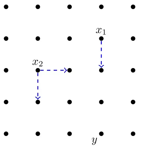

Otherwise, there are either one or two lattice points $n \in \mathbb{Z}^2$ such that
  1. $x$ and $n$ are adjacent
  2. $d_1(n,y) < d_1(x,y)$
We can think of these as "useful neighbors" of $x$ (relative to $y$) – travelling to a useful neighbor gets you closer to $y$, and travelling to a non-useful neighbor gets you farther away from $y$, so we will define $d$ recursively by travelling only to useful neighbors. In the figure below, $x_1$ has only one useful neighbor relative to $y$, while $x_2$ has two useful neighbors relative to $y$.
Illustraition of the idea of useful neighbors.

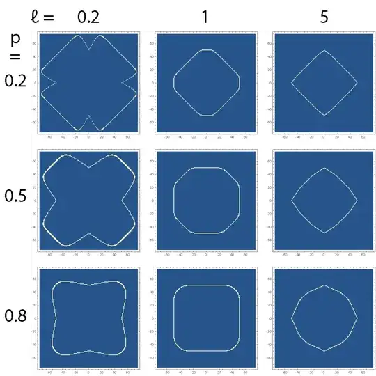

It's horrible to look at, but this gives a complete recursive definition of $d$. I implemented this definition in Mathematica to produce the following visualizations of the balls of radius $50T$ for various values of $\ell$ and $p$:
Images of the balls of radius 50T as ℓ and p vary
Indeed, $p=1/2, \ell=1$ gives an octagon!
