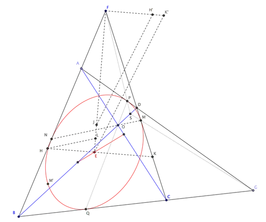

The figure below shows an example with the above method.
Ellipse tangent to quadrilateral

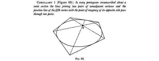

To construct one of the ellipses inscribed in the given convex quadrilateral, let us use Brianchon's hexagram theorem (see the book cited bellow, pp. 261-265). I used Corollary 1 (p.263) in my construction: enter image description here An auxiliary green line cuts the quadrilateral to give a pentagone. The ellipse inscribed in this pentagone is unique. We then construct one point of the ellipse on each side. GeoGebra finishes the work.
To check the construction, have a look here. It is possible to move the big blue points.
The orange lines are used for construction of the center by hand.
