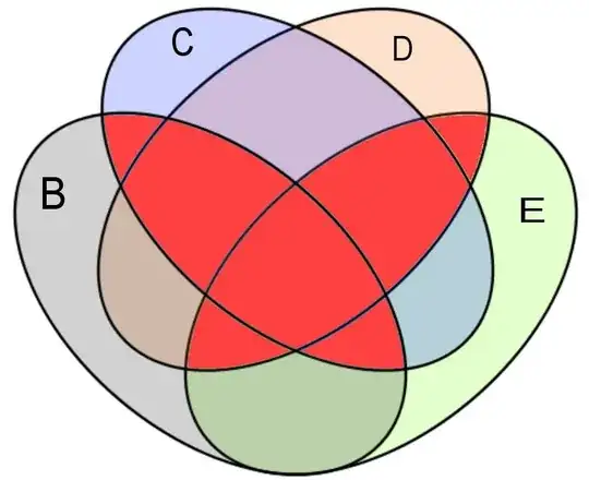

As pointed out by Asaf Karagila, there is no option to rewrite your expression in a simpler or more elegant way.
This can be demonstrated graphically:
The following is a Venn diagram for your case:

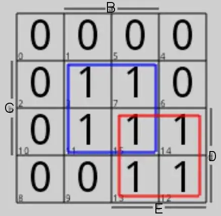

And here is the Karnaugh-Veitch map:
The two intersecting minterm blocks cannot be replaced by fewer or simpler minterm blocks.
