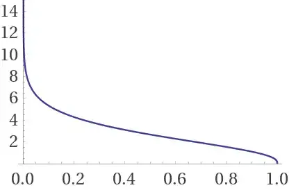

Here is a plot of our goal goal inverse function:
