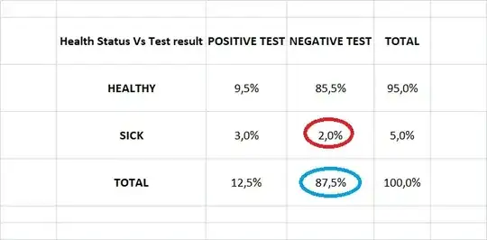

Now my only confusion is how the P(False Negative Result) differs from the Negative Predictive Value.
your calculation about false negative probability is correct. The result is about $2.29\%$
The difference between a negative (or positive) predictive value and the false negative (or positive) result is mainly that the predictive value is the probability that your disease situation is CONCORDANT with your test result
  • PPV: is the probability that you actually are sick, given that the test is positive
  • NPV: is the probability that you are actually healthy, given that the test is negative
What you are asked to calculate, is the probability that you actual situation is NOT CONCORDANT with test result; in particular, you correctly calculated the following probability
$$\mathbb{P}[\text{Sick}|T^-]=\frac{2.0}{87.5}$$
In these situation, a tabular representation using a contingency table will be very useful to visualize the situation
