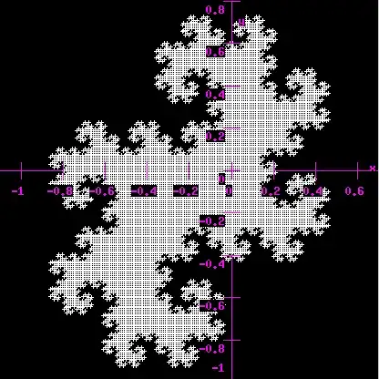

"Number systems are interesting from a geometrical point of view, too. If we allow negative powers of M to appear in the binary representation we get a possibly infinite representation of real vectors (we could say that we use a radix point). The boundary of the set of vectors with binary representation containing only negative powers of M (the set H of numbers with zero integer part) has mostly fractional dimension (it is a „fractal”). The output of the program can be used to analyze these sets. This means topological analysis, e.g. calculation of the dimension, connectedness etc. If we use the matrix M above, we get the following set:
