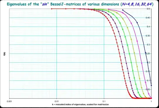

About question 1), stabilizing the eigenvalues of diagonalization for changing dimensions.
Just to make this better visible, I show two pictures, where the sets of eigenvalues for dimensions $N \in \{4,8,16,32,64,128\}$ are shown.
The indexes are rescaled to the interval $0..1$. The modification of the sets of eigenvalues seems nicely tamed instead of chaotic to me:
Even more tamed, if the x-axis is logarithmically scaled:
Perhaps from the second picture one can formulate a guess-function.
