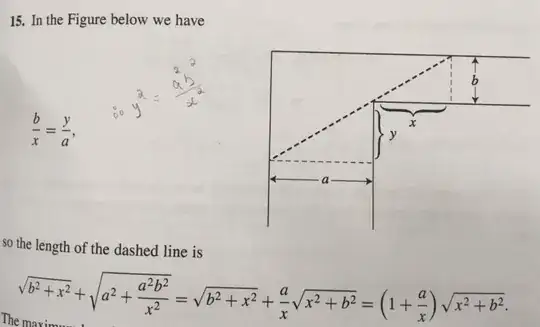

The offending line (i.e. the core concept that makes no sense to me) reads something like:
The maximum length of a ladder which can be carried horizontally around the corner is the minimum length of this dashed line.
...where the "dashed line" is depicted in the below photo:
Ladder

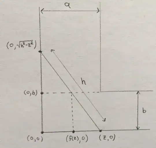

Fundamentally, I view The Ladder Around The Corner Problem as a variation of The Sliding Ladder Problem with the added constraint of the inner wall corner (i.e. the ladder's physical body, during the act of sliding, cannot move 'beyond' that inner corner).
The following picture will be helpful to reference:
Pic 2
The goal is to create a function $f$ that, for a given ladder height $h$ and hallway widths $a,b$, accepts as input a given horizontal distance $z$ that the 'bottom' of the ladder is displaced from the origin and outputs the associated horizontal distance of the latter at the height $b$.
For a given $z$, we can derive the equation of a line that represents the ladder: $y=mx+i$. To solve for the slope and intercept, it is straightforward to confirm that $i=\sqrt{h^2-z^2}$ and $m=\frac{-\sqrt{h^2-z^2}}{z}$. Given this equation, we can solve for what $x$ must be when $y=b$:
$b=\sqrt{h^2-z^2}\left(1-\frac{x}{z}\right)$
Rearranging and simplifying, we have $x=z-\frac{zb}{\sqrt{h^2-z^2}}$
This derivation was for a single $z$, however, we can also use this as the formula for our desired function: $f(z)=z-\frac{zb}{\sqrt{h^2-z^2}}$.
