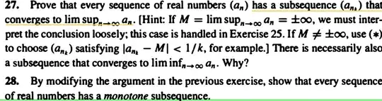

The question is: can we construct a monotone subsequence converging to limsup? The reason I asked this is that from the following exercises
My answer to 27 is the following:
For $\epsilon = 1$, we have $a_n< M + 1$ for all but finitely many $n$. Pick out these finite $n$'s, and denote the largest number of these $n$'s as $N_1$, and $M - 1 < a_n$ for infinitely many $n$, choose $n_1$ which satisfies $n_1>N_1$ (we can because Archimedean property).
For $\epsilon = 1/2$, we have $a_n< M + 1/2$ for all but finitely many $n$. Pick out these finite $n$'s, and denote the largest number of these $n$'s as $N_2$, and $M - 1/2 < a_n$ for infinitely many $n$, choose $n_2$ which satisfies $n_2>max\{N_1,n_1\}$ (we can because Archimedean property). Continuing we get $\{a_{n_k}\}$ as the subsequence. QED
The author seems to encourage me to imitate the argument in 27 to prove 28.
So I guess he implies that there is a monotone subsequence converging to limsup. But how?

  • If as you say $a_n<M+1$ for all but finitely many $n$ then there is no largest such $n.$ Therefore you cannot as you do denote "the largest of these $n$" as $N_1.$ [namely because there is no largest.] – coffeemath Sep 30 '21 at 03:42
  • @coffeemath, thank you, this mistake has been corrected now. – Hamilton Sep 30 '21 at 03:46
    When you say 'Pick out these finite $n$'s', you assume that there is at least $1$ for which $a_n \geq M + 1$. It could be the case that no such $n$ exists. – Matt E. Sep 30 '21 at 04:11
  • I see no such implication in Ex. 28. The goal is only to find a monotone subsequence, and the author suggests that the proof is similar (which you already know is true). – Michał Miśkiewicz Sep 30 '21 at 07:24

By combining your two stated facts, you can answer the question. Let $(a_n)_{n=1}^\infty$ be a sequence. Then some subsequence, say $(a_{n_j})_{j=1}^\infty$, converges to $\lim\sup a_n$ by your second statement. For ease of notation, set $b_j = a_{n_j}$. Then by your first statement, we know that the sequence $(b_j)_{j=1}^\infty$ has a monotone subsequence, say $(b_{j_k})_{k=1}^\infty$. The monotone subsequence $(b_{j_k})_{k=1}^\infty$ is a subsequence of $(a_n)_{n=1}^\infty$, so we're done.
