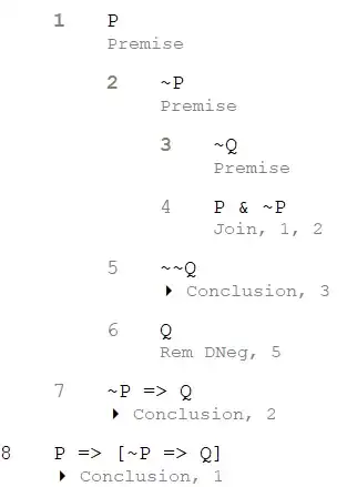

Here a proof using a form of natural deduction. For any propositions $P$ and $Q$, we have:
Source: Screenshot from my proof checker
