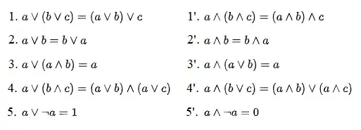

I think that the following question has a positive answer. Yet, I haven't managed to find it.
Consider the structure $\{0,1\}$ with operations $\lor,\land,\lnot$ defined in a usual way.
Is it true that the theory of this structure is axiomatizable by the axioms of Boolean algebra (written without $\forall$):
Сan you please recommend me some related basic level books (on logic or model theory), where I can find the proof.
P.S. I would be grateful if you told me the standard name of the structure.

One crucial observation is that each of the sentences you've written down is an equation - that is, the universal closure of an expression of the form "$t=s$." Now equations are preserved by Cartesian products, so for example every equation which holds in the two-element Boolean algebra ${\bf 2}$ also holds in the four-element Boolean algebra ${\bf 4}$. Consequently the sentences you've written down do not entail (for example) the sentence $$\forall x,y,z(x=y\vee y=z\vee z=x),$$ which is true in ${\bf 2}$ but false in ${\bf 4}$. Another example of such a sentence would be $$\forall x(x=0\vee x=1).$$
(I'm not sure that this "bolded number" notation is standard, but it is fairly common. In general, when it's clear from context that we're talking about structures in some class $\mathcal{K}$ where there is at most one structure up to isomorphism of each finite size, the notation "${\bf n}$" for $n\in\mathbb{N}$ is often used to refer to the isomorphism type of that unique structure. E.g. if we're talking about linear orderings, you may see "${\bf 2}$" used to denote the linear order with two elements, and so forth. I've also seen things like "$\mathbb{B}_2$" used to denote the unique-up-to-isomorphism Boolean algebra with two elements.)
This means that if we read "theory" as "first-order theory," your question has a negative answer. However, if we look at weaker logics than first-order logic, things change substantially: in fact that set of equations does generate the entire equational theory of ${\bf 2}$, that is, the set of all equations true in ${\bf 2}$. Equational logic is a very small fragment of first-order logic, and is studied in universal algebra.
