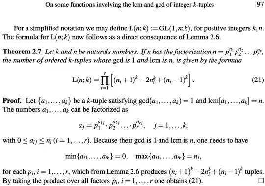

(Adding this community wiki answer to point out a relevant reference.) I was recently pointed to the following paper, in which this and related problems are proposed and solved:
Bagdasar, O. (2014.) "On some functions involving the lcm and gcd of integer tuples." Scientific Publications of the State University of Novi Pazar Series A: Applied Mathematics, Informatics and mechanics, 6(2):91-100. PDF (no paywall).
The result appears as Theorem 2.7 (cf. the comment of Yorch, too):
