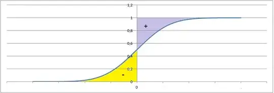

As per the continous formula you corrected posted this is the geometrical explanation
The expectation is the purple area minus the yellow one.
To verify this, simply integrate by parts you expression finding that
$$\int_0^{\infty}\left[1-F_X(x)\right]dx-\int_{-\infty}^0F_X(x)dx=\int_{-\infty}^{\infty}x f_X(x)dx=\mathbb{E}[X]$$

Thanks alot! The second integral will always be negative so we subtract it in order to "add" them up? If you could please do another step or two about integrating by parts as I'm not sure what to do there exactly. – Pwaol Sep 21 '21 at 07:55
Thanks for the help! all clear now, just my previous question, we subtract in order for us to add the negative area? (as in the image if the purple area was added to the negative yellow area we would get $0$?) – Pwaol Sep 21 '21 at 08:16
1@Pwaol : no, the yellow area must be subtracted! In the picture I showed I took a CDF of a Standard Gaussian, thus actually $E(X)=0$ – tommik Sep 21 '21 at 08:19
I see, I was confused because I was introducted to it by these integrals: $E^+(X)=\int_0^{\infty}xf_X(x)dx$ and $E^-(X)=-\int_{-\infty}^0xf_X(x)dx$, and thus $E(X)=E^+(X)-E^-(X)$, so the minus in the definition of $E^-(X)$ is to make sure we are subtracting them? I could have did $E^-(X)=\int_{-\infty}^0xf_X(x)dx$ and then $E(X)=E^+(X)+E^-(X)$? – Pwaol Sep 21 '21 at 08:24
