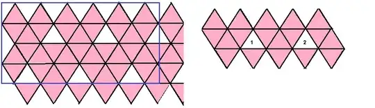

A double cover rough tessellation / development of an icosahedron at left is shown.
From it examined by symmetry which faces need to be deleted for the single cover... in order that all neighbor triangle cells are populated in the development .
That leaves the development with two cells/triangles deleted labeled $(1,2)$ leaving 18 faces intact as shown.
Hoping the procedure serves as aid to retain/delete cells (faces).
