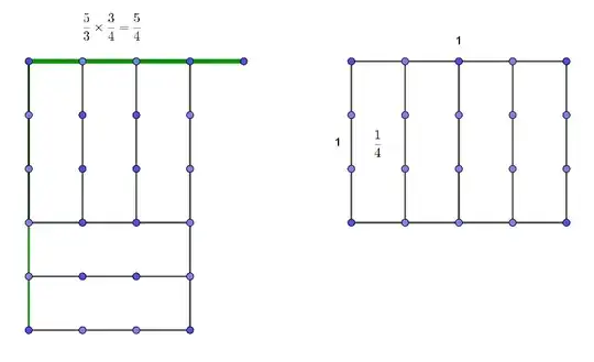

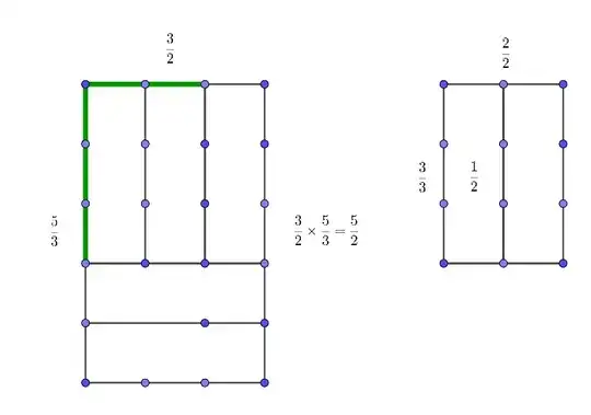

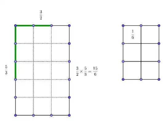

The thick green segments indicate the unit lengths in the indicated directions. The figures on the right indicate the "value" of the indicated square or rectangle.
