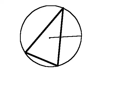

I think it may be something like this.
eccstartup
  • 1,126
