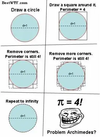

The fundamental problem with your approach is that you've been tripped up by the staircase paradox:
and see also https://en.wikipedia.org/wiki/Schwarz_lantern.
To be fair, I remember in high school being asked to do a whole bunch of textbook surface area and volume calculations using slicing arguments, and it was never explained to me why approximating volumes with shells and slices works or when and why the same thing could be done with surface area.
It turns out that unlike for volume, in order for the surface area of a sequence of approximations to a smooth surface to converge to the surface area of that smooth surfaces in the limit of refinement, you need both the surface positions and the surface normals to converge to those of the smooth surface. Pointwise convergence of the positions is not enough (as you've discovered).
So if you repeat your calculation using e.g. a sequence of piecewise truncated cones instead of annular rings, you should recover the correct surface area of the hemisphere.
