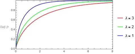

$F(x)$ for various values can be plotted with Mathematica in the following manner:
plotCDF[λ_, color_] := ParametricPlot[{-λ LogIntegral[p], p}, {p, 0, 1},
  PlotStyle -> color, Frame -> True, PlotLegends -> {"λ = " <> ToString[λ]}];
Show[{plotCDF[3, Red], plotCDF[2, Green], plotCDF[1, Blue]},
 PlotRangePadding -> None, AspectRatio -> 1/2, PlotLegends -> Automatic]
CDF for various values of lambda

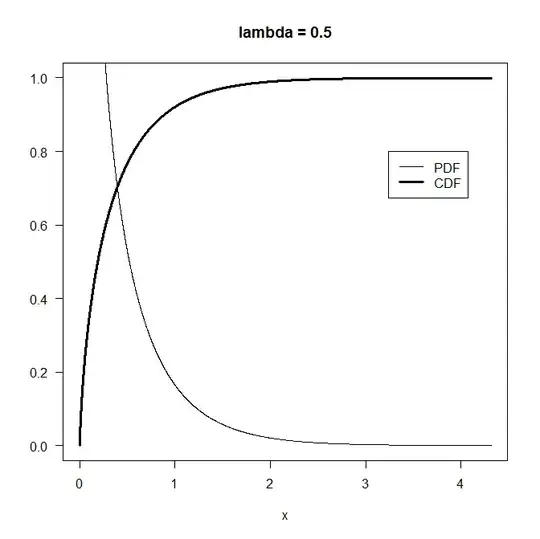

Using R one can evaluate the cdf and pdf using the pracma package:
# Load library
  library(pracma)
Set lambda
lambda <- 0.5
Generate x values based on the cdf
cdf <- (1:9999)/10000 x <- -as.numeric(li(p)) * lambda
Plot of CDF
plot(x, cdf, type="l", las=1, xlab="x", ylab="", lwd=3, main=paste("lambda =", lambda))
Add in pdf
lines(x,-log(p)/lambda)
Legend
legend(min(x)+0.75*(max(x)-min(x)),0.8, c("PDF", "CDF"), lwd=c(1,3))
cdf and pdf for lambda = 0.5

  • Thanks for this exhaustive answer. So the right value for $c$ is $0$ and $$F(x)=li^{-1}(-\frac{x}{\lambda})$$ is a valid CDF for a random variable (and the plot is the one in the pic). – met.91 Aug 24 '21 at 08:39

  • Another question: is there a way to calculate the PDF (so the derivative of $F(x)$) and to plot it? – met.91 Aug 24 '21 at 10:20
  • I've just found out in a paper (De Reyna, Toulisse - The n-th prime asymptotically) that the derivative of $li^{-1}(x)$ is equal to $log(li^{.1}(x))$. So, for the particular case that I'm studying, it's true that $$F(x)=li^{-1}\Bigl(-\frac{x}{\lambda}\Bigr)$$ and $$f(x)=\frac{d}{dx}F(x)=log\Bigl(li^{-1}\Bigl(-\frac{x}{\lambda}\Bigr)\Bigr).$$. Is this correct? How to plot it? – met.91 Aug 24 '21 at 11:00
  • I've just realized that I forgot to put the derivative of $-\frac{x}{\lambda}$ into the expression of the derivative $f(x)$. So it should be $$f(x)=- \frac{log\Bigl(li^{-1}\Bigl(-\frac{x}{\lambda}\Bigr)\Bigr)}{\lambda}$$ – met.91 Aug 24 '21 at 14:50
    Both approaches avoid the direct calculation of $li^{-1}$. But if that is what is needed, then you'd really need to specify what software package you use. Take a look at https://math.stackexchange.com/questions/853178/numerical-inverse-of-logarithmic-integral/853192. – JimB Aug 24 '21 at 16:41
  • I only need to have an analytic expression of CDF and PDF and I have to be sure that both are valid functions for a random variable. Thanks to your plots, I can see that they're valid, so I think that I can affirm that my random variable has $$F(x)=li^{-1}(-\frac{x}{\lambda})$$ as CDF and $f(x)$ (of my last comment) as PDF. Thanks for your help! – met.91 Aug 24 '21 at 17:09
