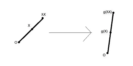

Let $\lambda\geq1$ and $X\in V$. Then $Y=\lambda g(X)$ is the unique vector satisfying $||Y||=\lambda||X||$ and $g(X)$ lies on the line segment $OY$.
As $X$ lies on the line segment $O(\lambda X)$, we know $g(X)$ lies on the line segment $O(g(\lambda X))$. Further we know $||g(\lambda X)||=\lambda||X||$. Thus $g(\lambda X)=\lambda g(X)$.
The cases $\lambda\leq0$ and $\lambda\in (0,1)$ follow analogously.

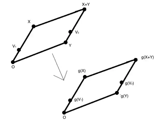

Now consider a pair of vectors $X,Y$. We have a parallelogram $OX(X+Y)Y$. Thus for $\delta\in (0,||X||)$, if $V_1$ lies in the line segment $OX$, at distance $\delta$ from $O$, and $V_2$ lies in the line segment $Y(X+Y)$, at distance $\delta$ from $Y$, then $||V_1-V_2||=||Y||$.
Applying $g$ to this configuration, we must obtain a parallelogram $O(g(X))(g(X+Y))(g(Y))$, as $||g(V_1)-g(V_2)||=||g(Y)||$, for all $\delta\in (0,||X||)$. Thus $g(X+Y)=g(X)+g(Y)$.
