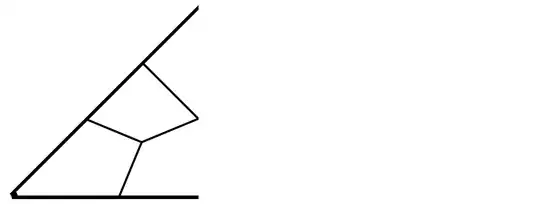

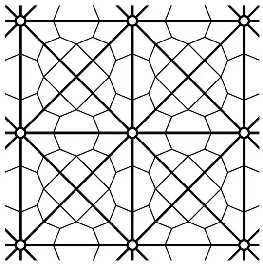

The given pictures are of some tiles typically known as Persian tiles- enter image description here enter image description here The second picture is of one single tile while the first one gives the tiling using those tiles.

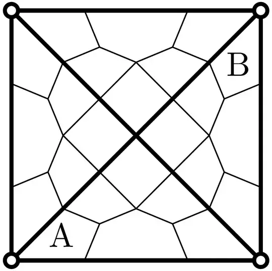

Each vertex in the Persian tile is surrounded by eight quadrilaterals. Show that given any two such quadrilaterals $A$, $B$ (similar to what marked in the second image), there is a unique symmetry which carries $A$ to $B$. Find a formula for the symmetry with $A$, $B$ as shown. You may assume that the lower left vertex in the given figure is the origin and the upper right one is $(2,2)$.
Fun problem: What proportion of area in $\mathbb R^2$ is covered by the inner slanted squares? You can assume that the octagon formed at the middle due to two adjacent tiles is a regular octagon.
I noticed that the first problem looks trivial if $A$ and $B$ are connected to the same vertex. In that case, you only need to perform a suitable rotation combined with a suitable reflection. But, it doesn't look very easy to prove that this symmetry is unique. Also, if $A$ and $B$ are connected to two different vertices, I think, we will have to do some more rotation and translations. But again, how do I prove that the symmetry is unique? Also, how do I find an explicit formula?

I think the best way to think about this type of problem is to find what is called a fundamental domain for the (group of) symmetries of the tiling. Intuitively, a fundamental domain is a smallest repeating unit from which the whole pattern is made. Of course the pattern can be built using the square tiles, but each square tile itself has symmetries, and can be built out of 8 smaller 45-45-90 triangles, each of which has no internal symmetries:
A fundamental domain
The key observation is that there exists a symmetry taking any copy of a fundamental domain to any other copy of the fundamental domain, and since this a fundamental domain has no symmetries itself, there this symmetry is unique.
Therefor there is a unique symmetry taking the green fundamental domain to the blue one, and it's not too hard to see that this symmetry is the reflection in the red line.
Fundamental domains containing A and B related by a reflection
More generally, here is how you might try to find a symmetry sending one copy of a fundamental domain to another. Notice that every copy to the fundamental domain has exactly one corner at a circle. So we can choose vertical and horizontal translations so that these circles match up. Now using your observation, we have apply rotations centred at that circle, and reflections in lines through that circle to make the fundamental domains line up. Applying this approach to the case of A and B in your question, first we would translate left by 2 and up by 2 to make the circles line up, and then reflect in a diagonal line:
Fundamental domains containing A and B related by a translation and a reflection
First we translate the green triangle to the purple one, and then reflect in the red line. I will leave it as an exercise to a) convince yourself that the two symmetries I have described are in fact the same symmetry in disguise, and b) use these descriptions to write down an explicit formula.

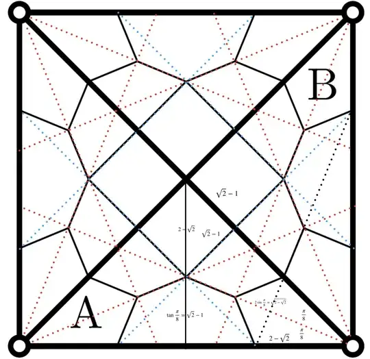

As for the area of the quadrilaterals, I assume that the construction of the tile is based on the intersections of the angle bisectors represented by the dotted red lines in the diagram below, in which the length of the sides of the large square is taken to be $2$ units. If that's the case, then I get $\ 3-2\sqrt{2}\approx0.17\ $ square units for the area of the quadrilaterals A and B, and of the small squares in each quadrant of the diagram. I get $\ \frac{3}{\sqrt{2}}-2\approx0.12\ $ square units for the area of each of the other four quadrilaterals in each quadrant. If this is correct, then the area of one of the small central squares, and the quadrilaterals congruent to A and B, would be approximately $17\%$ of that of a quadrant. The slanted centrals squares in the tiling would therefore cover that proportion of $\ \mathbb{R}^2\ $

  • +1. I agree that the construction seems to assume the use of angle bisectors (although this may not actually be so). With the minimal assumption that a vertex of a small square lies on angle bisectors from the big square's corners (so that the vertex is the incenter of a right triangular "quadrant" of the big square), you can get to the Fun Problem result simply by calculating the area-ratio of the small square to its quadrant: $\frac{(\sqrt{2}-1)^2}{2^2/4}=3-2\sqrt{2}$. There's no need to bother with the other quadrilaterals (whose shapes require additional assumptions). – Blue Aug 17 '21 at 05:12
  • This was a beautiful geometry. A great answer (+1)! – Sayan Dutta Aug 17 '21 at 18:55
  • On rereading the question, I see that the "fun problem" was in fact (effectively) to find the proportion of the tile covered by the central squares, and not, as I had assumed, to find the areas of the quadrilaterals A and B. As Blue noted, to get those, you need more than just the intersections of the angle bisectors, but not all that much more. – lonza leggiera Aug 17 '21 at 23:31
  • I assumed that the pentagonal figure based on the centre of each side intersected the side at the same points where the extensions of the sides (i.e. the dotted blue lines in the diagram) of the small central square did, and its vertices were thus those two points and the intersections of the angle bisectors. The rest of the quadrant is then filled out by reflecting each half of this figure about its side which lies on an angle bisector. – lonza leggiera Aug 17 '21 at 23:31
  • I knew there had to be something more to find the answer of the fun question. But, I just checked with the source of the question, and found out that the extra information is not what you assumed, but the fact that the octagon formed at the middle due to two adjacent tiles is a regular octagon. I'll add this to the question as well. Do you maybe want to place an edit in your question proving that the two are equivalent... (they're of course equivalent since the answer matched) – Sayan Dutta Sep 18 '21 at 14:37
  • I don't think the mere fact the octagon formed from joining the two quadrilaterals on either side, and in the middle, of the common edge of two adjoining large squares is regular is enough to uniquely pin down the figure. Without some further restriction, you could make that octagon have a side length of any size from $\ 0\ $ to $\ \big(2-\sqrt{2}\big)^\frac{3}{2}\ $ (not inclusive), and the small central square correspondingly smaller, and still have a tile with the same set of symmetries. – lonza leggiera Sep 19 '21 at 04:43
  • Of course, the semi-octagons erected on the sides of the small central square would then not necessarily be half of a regular octagon. Specifying that as an extra condition, however, would be enough to make the tile unique. – lonza leggiera Sep 20 '21 at 02:06
