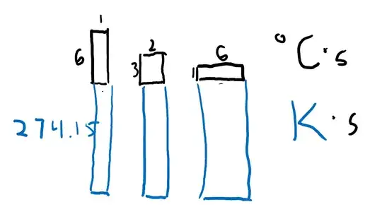

    Since you cannot add temperatures, the concept of average temperature doesn't exists? That would be quite a claim. – lalala Aug 09 '21 at 08:34
    @lalala But you don't get an average temperature by adding the temperatures. You get an average temperature by converting all the temperatures to the same unit, stripping off the unit, adding the magnitudes, then dividing that sum by the count, and finally you can put the temperature unit back. Because the total of the magnitudes has no meaningful unit. It's not a temperature. It's just a number. – mdfst13 Aug 09 '21 at 09:35
  • So you say I could not add temperatures, but if I want I can take the magnitude add those and then add the unit? Do you think of adding of unit quantities always like that? Like 1s+1s - > 1 +1=2 - >2s? – lalala Aug 09 '21 at 10:59
    No, because both one and two seconds are meaningful. But if I add 50 deg and 100 deg, it's not a 150 deg temperature. Even if they average to 75 which is. It's meaningful to add time periods. Now, if we are talking dates, it is not meaningful to add two dates. E.g. today and tomorrow don't make a new date in 2042. So dates are like temperatures, but time periods are not. They're like temperature differences which can also be added. – mdfst13 Aug 09 '21 at 11:05
