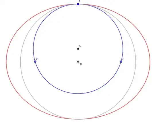

If the blue circle with centre $O$ is the original, and $A$ is also on the perpendicular bisector of $BC$ then the red ellipse is the locus of all points on the plane which would have constant sum of distances to the foci $B$ and $C$ adding up to $AB+AC$.
The red ellipse contains the grey circle with centre $D$ (the midpoint of $BC$) which touches $A$ since the grey circle can be seen as the red ellipse scaled horizontally, and the grey circle contains the blue circle because $O$ lies between $A$ and $D$ so the blue circle can be seen as the grey circle scaled vertically.
So all other points on the blue circle would have sum of distances to $B$ and $C$ less than $AB+AC$.

  • Awesome intution. It helped me to understand why always the middle of the arc works. Thank you –  Aug 05 '21 at 08:08
