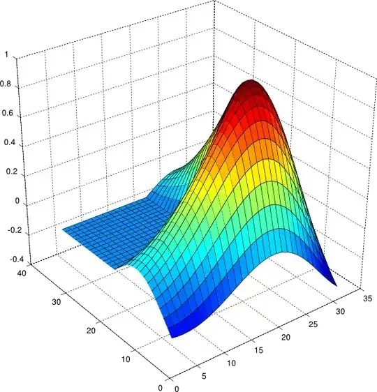

Does it matters with the shape of solution domain? YES! It matters a lot, normally separability relies on if we can express the domain as a "rectangle", i.e., $[a_1, b_1] \times [a_2,b_2]\times\cdots\times [a_n,b_n]$, not matter in cylinderical type of coordinates or polar coordinates. For example, MATLAB's famous icon: lambda
is the eigenfunction for Dirichlet-Neumann mixed boundary problem for
$$ -\Delta u =\lambda u $$ in the L-shape domain. This can't be solved using separation of variable in contrast of that the intuition for above problem is that it can be solved using separation variables. Well, let's analyze it a bit. Homogeneous Dirichlet boundary condition is imposed in the L-shaped non-convex corner, while other sides just have homogeneous Neumann boundary condtion. Every eigenfunction $u_n$'s behavior near the non-convex corner is $$ u_n \sim \alpha_n r^{2/3}\sin \Big(\frac{2}{3}\theta\Big) + o(r^{2/3}) \approx \alpha_n(x^2+y^2)^{1/3}\sin\left(\frac{2}{3}\arctan (y/x)\right), $$ (in the second quadrant we need add another $\pi$ to the $\arctan$). While on the outer rim (side adjacent to convex corners) it behaves like $$u_n\sim \beta_n(a\cosh(n\pi x) + b\sinh(n\pi x))\cos(n\pi y), $$ or the $\cos$ is in $x$ and hyperbolic functions are in $y$. To describe both singular and wave like behavior on both sides of L-shaped domain, $u_n = X(x)Y(y)$ this kind of a one shot expression does not exist.
