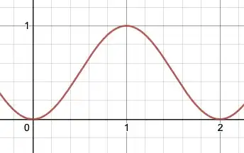

I need to create some fake data that sort of conforms to the slow start, randomness in the middle, then a slow finish.
I've screwed around with a graphing calculator and normalized this simple function to start at 0 and end at 1.
How would I go about creating multiple variations of this function (or another function) where Y is always increasing but at different rates?
To be clear, the function should start at 0,0 and end at 1,1 with Y always increasing. I'm looking for a way to programatically create "random-ish" plots.

  • Thanks for the explanation. I settled on x^.5, x, and the original cos function that I made as my three weighted functions – lewicki Jul 28 '21 at 04:52
