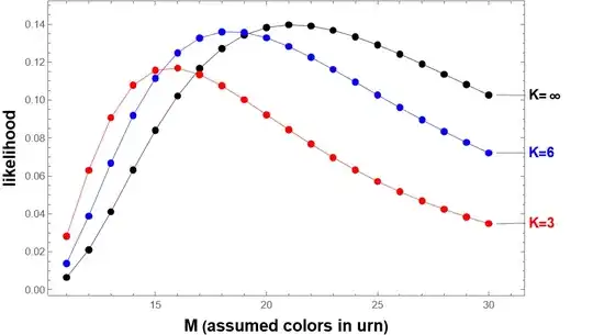

Let's assume the frequencies of the colors of the drawn balls to be $k_i=(1, 2, 1, 1, 1, 2, 1, 1, 3, 1, 1)$. It follows that $n=15, m=11, K\ge 3, M\ge 11$. The multiplicities of the frequencies in $k$ are $z_j=(1,2,8)$ for $l=3$ different elements in $k$. Plotting the likelihoods shows that there are most likely $21$ different colors in the urn for drawing with replacement ($K=\infty$, black curve). For drawing without replacement and assuming that there are not more balls per color than given by the example ($K=3$, red curve), we get $16$ different colors in the urn as most likely variant. Assuming that in the urn were $K=6$ balls per color we get $18$ colors (blue curve). For higher $K$ the black curve is approached.
