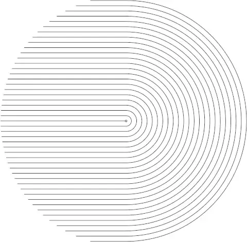

The non-orientable foliation below on the punctured disk shows that a $1$-dimensional distribution does not generally have a continuous nowhere vanishing section.
That doesn't mean the punctured disk has no non-vanishing vector field, of course, it just means that we can't generally select a continuous, non-vanishing vector field from a given distribution.
The field of lines on a Möbius strip is another example, but the punctured disk may be more impressive since its tangent bundle is trivial.
A foliation of the punctured disk not inducing a non-vanishing vector field
  • This is very impressive! I guess my original concerns about this problem should be clear, however, I can't help ask if the existence of 1-dim distribution implies a non-vanishing vector field, without restrictions on that distribution. I guess this is very hard and not always true? – jingyey Jun 23 '21 at 03:04
