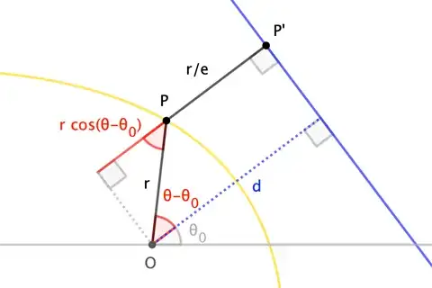

The second-degree equation $Ax^2+Bxy+Cy^2+Dx+Ey+F=0$ corresponds to a conic in general position. Moving its focus to the origin imposes certain relations on the coefficients that can be difficult to describe.
It's easier to start with the definition that a (non-circle) conic is the locus of a point whose distance to a given point (the focus) is a constant (the eccentricity) times its distance to a given line (the directrix).
$$\text{distance to focus} = \text{eccentricity} \cdot \text{distance to directrix} \tag{0}$$
In the figure, $O$ is the focus, $P$ is the point on the conic, and $P'$ is the projection of $P$ onto the directrix, the line at distance $d$ from $O$ whose normal makes an angle $\theta_0$ with the $x$-axis.
Writing $r$ for $|OP|$ and $\theta$ for the angle $\overline{OP}$ makes with the $x$-axis (that is, taking $(r,\theta)$ to be the polar coordinates of $P$), we have $$d = \frac{r}{e}+r\cos(\theta-\theta_0) \quad\to\quad r = \frac{de}{1+e\cos(\theta-\theta_0)} \tag{1}$$ It's customary to replace $de$ with, say, $\ell$ for the length of the semi-latus rectum (the length $r$ when $\overline{OP}$ is parallel to the line; ie, when $\theta-\theta_0=90^\circ$). $$r = \frac{\ell}{1+e\cos(\theta-\theta_0)} \tag{2}$$ This allows the formula to apply to circles, as well. $\square$
For the corresponding Cartesian formulation, we square relation $(0)$ and write $$x^2+y^2=e^2 \left(x\cos\theta_0+y\sin\theta_0-d\right)^2 \tag{3}$$ Expanding and re-arranging, we have $$\begin{align} 0 &= x^2(1-e^2\cos^2\theta_0)+y^2(1-e^2\sin^2\theta_0)-2xye^2\sin\theta_0\cos\theta_0 \\ &\quad+2xde^2\cos\theta_0+2yde^2\sin\theta_0 -e^2d^2 \end{align} \tag{4}$$ Again, we can replace $de$ with semi-latus rectum $\ell$ to get a version that works with circles: $$\begin{align} 0 &= x^2(1-e^2\cos^2\theta_0)+y^2(1-e^2\sin^2\theta_0)-2xye^2\sin\theta_0\cos\theta_0 \\ &\quad+2xe\ell\cos\theta_0+2ye\ell\sin\theta_0 -\ell^2 \end{align} \tag{5}$$ I should note that multiplying-through by some arbitrary (non-zero) constant scales the coefficients of $(5)$ without affecting the conic itself. Accordingly, when comparing the general second-degree equation $Ax^2+Bxy+Cy^2+Dx+Ey+F=0$, we have to allow for the constant, say $k$, so that $A=k(1-e^2\cos^2\theta_0)$, $C=k(1-e^2\sin^2\theta_0)$, etc. This adds some complexity to retrieving the geometric parameters from the coefficients; see, for instance, this answer.

  • Very nicely articulated! What do you use for your diagrams? Doesn't look like GeoGebra. – Math Lover Jun 06 '21 at 08:17
  • @MathLover: Thanks! :) ... I did indeed use GeoGebra for my diagram. – Blue Jun 06 '21 at 08:25
  • ok that tells my proficiency in GeoGebra :) one other point, you should probably clarify in your answer that $d$ in the equation of conic in general position is different than $d$ you use later on for distance from focus to the directrix. – Math Lover Jun 06 '21 at 08:49
  • Btw, what relation is there for e .. like $e=\frac{b^2-4ac}{(a+b)^2}?$ – Narasimham Jun 06 '21 at 08:55
    @MathLover: I've refined my GeoGebra style over time. :) ... I've switched the coefficients of the second-degree polynomial to upper-case to avoid confusion with parameters used later. Thanks for the suggestion. – Blue Jun 06 '21 at 09:15
  • @Narasimham: I've edited the answer with a note about retrieving geometric parameters from coefficients, referencing this answer. – Blue Jun 06 '21 at 09:17
