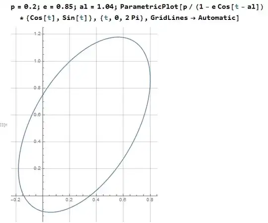

If $\alpha $ is rotation angle around the focus situated at origin, the standard polar Newton form is easily modified:
Single radius vector
$$ \dfrac{1}{r}= \dfrac{1- e \cos (\theta- \alpha) }{p}$$
when parameterized to Cartesian:
$$ (x,y)= r (\cos \theta, \sin \theta)$$
