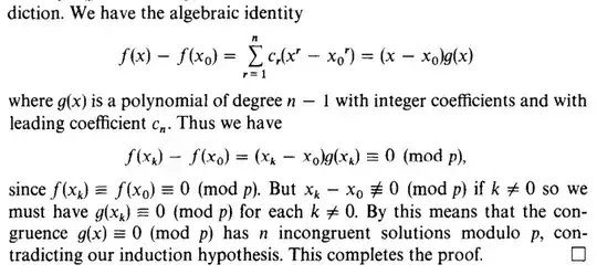

The question is how to factor an identity. The identity is shown below but it uses $f(x)$ as defined in Theorem 5.21, so let me show $f$'s definition first.
def of f(x)
In the proof, we eventually get to this identity:
algebraic identity
We have two equations there. I'm good with the first. Just expanding it out makes it obvious. My problem is on the second equation. By taking the expansion and factoring $x$ on all non-$x_0$ terms, I get
$$x(c_n x^{n-1} + \cdots + c_2 x + c_1).$$
Similarly for $x_0$,
$$x_0(c_n x_0^{n-1} + \cdots + c_2 x_0 + c_1).$$
Question. How can I use these two expressions and get the second equation in the identity?
If I let $g(x) = (c_n x^{n-1} + \cdots + c_2 x + c_1)$, then I have $g(x)$ in the first expression above and $g(x_0)$ in the second. These are not the same, so I'm puzzled as how this is allowed.
