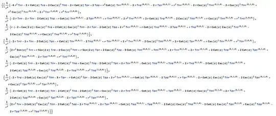

Here is a screenshot. I've removed the redundant [r,θ,ϕ] all over the place. Note that in Mathematica, the (a,b,c) superscript means an a-fold partial derivative in the first argument of the function and so on.

  • thank you for your detailed answer which is really helpful. i am wondering why the final answer does not have the partial derivative of elements in T? for example, I expect there should be some term like \frac{\partial^{2}T_{rr}}{\partial r^{2}}, but I do not see it. – Wz S May 12 '21 at 19:42
  • @WzS Goodness me, good catch. I should have made the components of $T$ functions of $r,\theta,\phi$. Please disregard this answer as it is now. I will correct it. – K.defaoite May 13 '21 at 00:17
  • @Wzs I pasted the updated result from Mathematica. I will typeset it at some point in the next few days. – K.defaoite May 13 '21 at 00:25
  • really thank you. I know this is kind of tedious. so really thank you for your patience. But I still wondering there should be some second-order derivatives rather than just first-order shown in the result now, what do you think? – Wz S May 13 '21 at 01:18
  • @WzS You're right, that is... curious. I'll investigate. – K.defaoite May 13 '21 at 01:27
  • @WzS I found the error. I forgot the double square bracket around coords. – K.defaoite May 13 '21 at 01:35
  • @WzS I uploaded the new result. I think finally this is right! I'm really sorry about the several failed attempts. I'll typeset this sometime in the near future, but for now the screenshot is available. It contains second derivatives as expected. – K.defaoite May 13 '21 at 01:40
  • thanks, I think now it is in a good form. you do not have to type it, you have already done enough, I am going to type it myself and am glad share to you if you need it. Again, really appreciate it. just want to make sure the notation, the T_{rr}^(0,1,0) means \frac{\partcial{T_{rr}}}{\partcial\theta}, right? – Wz S May 13 '21 at 02:58
  • @WzS Yes, that's right. – K.defaoite May 13 '21 at 11:56
