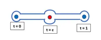

To evaluate $I_1$ we go in the complex plane and integrate along the following contour, going clockwise:
To make the contour closed we have to add two small semi-circles of radius $r$ around $t=c$ on the upper and lower banks of the cut (in both cases we go clockwise), $I_{c_+}, I_{c_+}$, and two small circles around $x=0$ and $x=1$. It is easy to seet that last two integrals (around $x=0$ and $x=1$) $\to 0$ as $r\to0$, and $$\oint=I_1 +I_{c_+}-(-I_1)+I_{c_-}\Rightarrow \,2I_1=\oint-I_{c_+}-I_{c_-}$$
$$I_{c_+}=\sqrt{c(1-c)}\int_{\pi}^0\frac {ire^{i\phi}}{-re^{i\phi}}d\phi=\pi i\sqrt{c(1-c)}$$ $$I_{c_-}=-\pi i\sqrt{c(1-c)}$$ so the last two integrals cancel each other, and we are left with $I_1=\frac{1}{2}\oint$.
Because there are no singularities outside the contour, we can deform it making a big circle of radius $R\to\infty$ $$\oint=\int_{2\pi}^0\frac{\sqrt{Re^{i\phi}(1+Re^{-\pi i}e^{i\phi})}}{c-Re^{i\phi}}iRe^{i\phi}d\phi=i\sqrt{e^{-\pi i}}\int_0^{2\pi}\frac{(Re^{i\phi})^2\sqrt{1-\frac{1}{Re^{i\phi}}}}{Re^{i\phi}(1-\frac{c}{Re^{i\phi}})}d\phi$$ $$=\int_0^{2\pi}Re^{i\phi}\Bigl(1-\frac{1}{2Re^{i\phi}}+...\Bigr)\Bigl(1+\frac{c}{Re^{i\phi}}+..\Bigr)d\phi=2\pi\Bigl(c-\frac{1}{2}\Bigr)$$ Therefore, $$I_1(c)=\pi\bigl(c-\frac{1}{2}\bigr)$$
