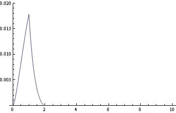

For large $t$ $f(t)\sim t$, while for small t $f(t)\sim t^2$. Then for large $y$ $f^{-1}(y)\sim y$ and for small $y$ $f^{-1}(y)\sim \sqrt y$. Using this as a first approximation in Newton's method gives the following approximation: $$ f^{-1}(y)\sim h(y)=\begin{cases} \sqrt{y}-\frac{-y-e^{-\sqrt{y}} \sqrt{y}+\sqrt{y}}{e^{-\sqrt{y}} \sqrt{y}-e^{-\sqrt{y}}+1}& 0<y<1,\\ y+\frac{e^{-y} y}{e^{-y} y-e^{-y}+1}& y\ge1. \end{cases} $$ This is the graph of $f^{-1}(y)-h(y)$:

Given $y>0$, let $g(t)=f(t)-y$. Newton's method to solve $g(t)=0$ consists in iterating the function $N(t)=t-g(t)/g'(t)$ starting with an initial guess $t_0$. If $y<1$ take as initial guess $t_0=\sqrt y$; if $y\ge1$ take $t_0=y$. – Julián Aguirre Jun 07 '13 at 17:15
