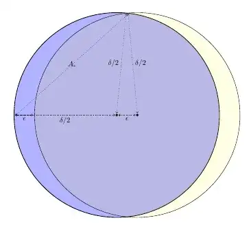

Consider the following cover of the closed ball by open balls:
Consider placing an open ball of radius $δ/2$ with centre a distance $ε< δ/2$ from the centre of $U$, as pictured below. You can then try and cover the remaining points (a deeper shade of blue) by any open ball of radius greater than $A_ε$, where $A_ε>0$ is the distance shown in the diagram.
Cover of U by shifted ball
Some cheeky Pythagoras on these triangles (dropping the perpendicular of the isosoles triangle) tells you that
$$ A_ε^2 = \left(\frac δ2 + \frac {3ε}2\right)^2 + \left(\frac δ2\right)^2 - \left(\frac ε2\right)^2 = \frac{3 δ}{2} ε + 2 ε ^2. $$
Therefore, for $ε$ sufficiently small, the doubled-in size ball has diameter $4A_\epsilon ≤ δ$, and hence the cover by this and the original ball gives
$$H^s_δ(\overline U) \leq δ^s + 4^{s}A_ε^s,$$
and taking $ε → 0$ gives the result.
